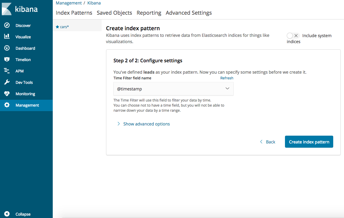

I have used logstash with jdbc to transfer data from a mySQL databse to ES. However when I try to create an index pattern in Kibana I get the following error-message:
"Could not locate that index-pattern (id: false), click here to re-create it"
I do get: "Success! Your index pattern matches 1 index." in step 1. But after clicking "Create index pattern" in step 2, i get the error-message.
What could be the problem?

Hi!
  1. 6.3.0 (for all three)
  2. This screens gets shown after I have clicked "Create index pattern" in step 2. The error automatically sends me back to step 1 as you can see.

Hi,
So this error comes in when you are trying to open a object associated with that index-pattern. Looks like you have leads as your indices in elasticsearch. Can you please click ok and try to create leads index pattern?
Also what is the reference to step 2 here? Creating an index pattern page - 2 where you can pick a timefield if it exists or something else?

Hi!
These are all steps in chronological order.
//C
