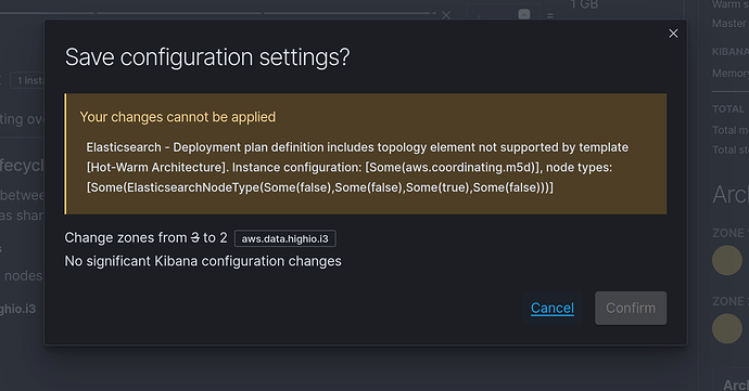

I am struggling to update a deployment. I made some changes successfully yesterday. However today, when I want to change my node configuration, I get this message:

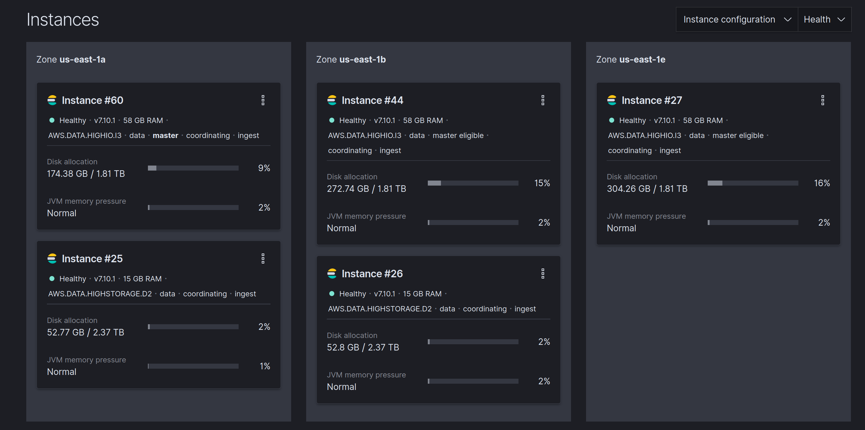

I don't understand the message because there is no dedicated coordinating node. Maybe there was an error with one of the nodes be set as a coordinating node. I did have more nodes yesterday, including master nodes. But I removed then yesterday as well.
Not sure where to go from here. I restarted the nodes hoping it would fix itself. I have tried many different configuration changes, but any change get this message.
