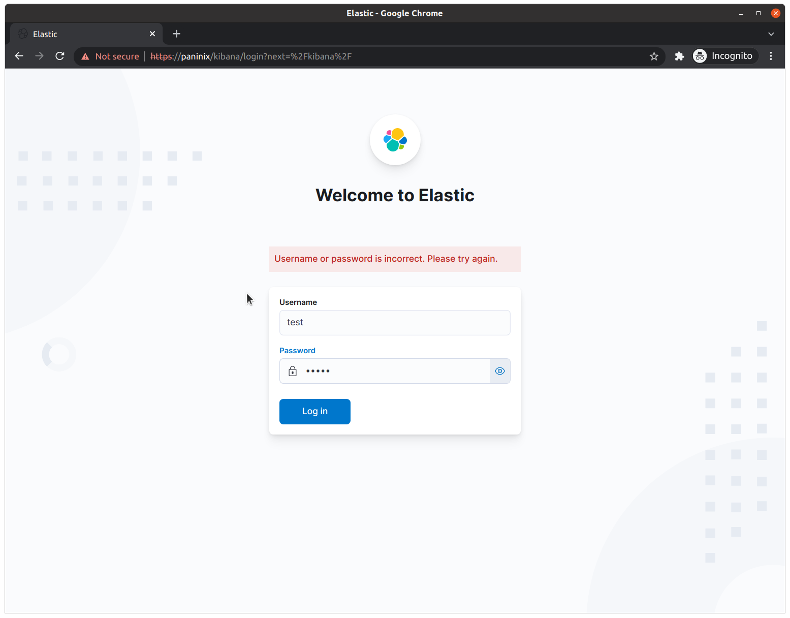

Do you see any error messages in the Elasticsearch logs when you attempt a failed login?
Something funny is going on. In 7.14.2, the error message for failed login is not "Oops! Error. Try again"
I suspect the login screen is being served from a Kibana 6.8 instance. The "Oops" message appears in the 6.8 branch but not the 7.14 branch:
https://github.com/elastic/kibana/blob/6.8/x-pack/plugins/security/public/views/login/components/basic_login_form/basic_login_form.tsx#L207
Actually this was the exact error message of my 7.14.2 instance - "Oops! Error. Try again".
Problem solved, I was missing the native realm configuration in the Elasticsearch.yml.
