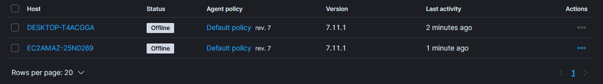

Hi guy's i'm setting up an elastic-agent on a Windows machine... and looking through the logs i'm seeing the following error:
{"log.level":"error","@timestamp":"2021-03-03T09:41:49.593-0500","log.origin":{"file.name":"application/fleet_gateway.go","file.line":187},"message":"Could not communicate with Checking API will retry, error: could not decode the response
I can make a request just fine via the browser or through CURL just fine at the https://kibana.mydomain.com/api/fleet/agents/e416bec0-7c17-11eb-a501-6d52f7426339/checkin URL... so not sure what the issue is.
^ I can make a test POST request to the endpoint just fine... not sure why elastic-agent is throwing the error.
Also i'm receiving Elasticsearch data just fine to my Elasticsearch endpoint to https://elasticsearch.mydomain.com ... it's just that Kibana can't make this request and then the ElasticAgent shuts down and stops working :frowning:
Note: I am using Cloudflare and nginx as a reverse proxy to both my Kibana and ElasticSearch endpoints.
Anyone have any ideas what the issue may be?

Also please look at this... ElasticAgent (on the right) can't send the request for some reason.. while I make make the same CURL request on the left?
@nchaulet i'm able to install the elastic agent and i'm receiving logs with Elasticsearch.. what's stopping that CheckIn request? Do I need to provide credentials somewhere for it?
After awhile... it ends up killing the agent :frowning:
