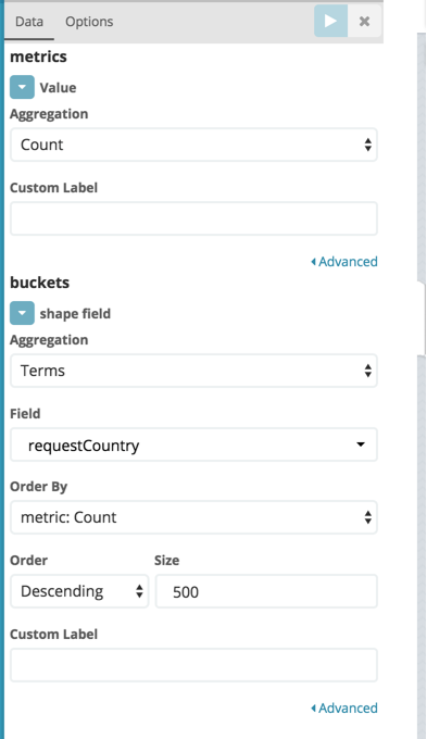

In the Data-tab, you would do terms-aggregation on your requestCountry-field and then select the iso-2 field in the Options-tab.

This is my data tab:
data

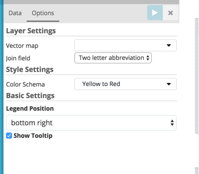

On my instance, the vector map is empty. Am I supposed to select something there?
vector
Regardless it does not work. I guess it's trying to highlight US state or something? When I click on vector map, I have an empty list and nothing to select. I am on elastic cloud with Kibana 5.5.2.
Thanks!
hi @snicoll,
You are running into this known bug: https://github.com/elastic/kibana/pull/13931.
It has been fixed but will only be available at the next patch release. This usually takes a couple of weeks. Apologies for the inconvenience.
