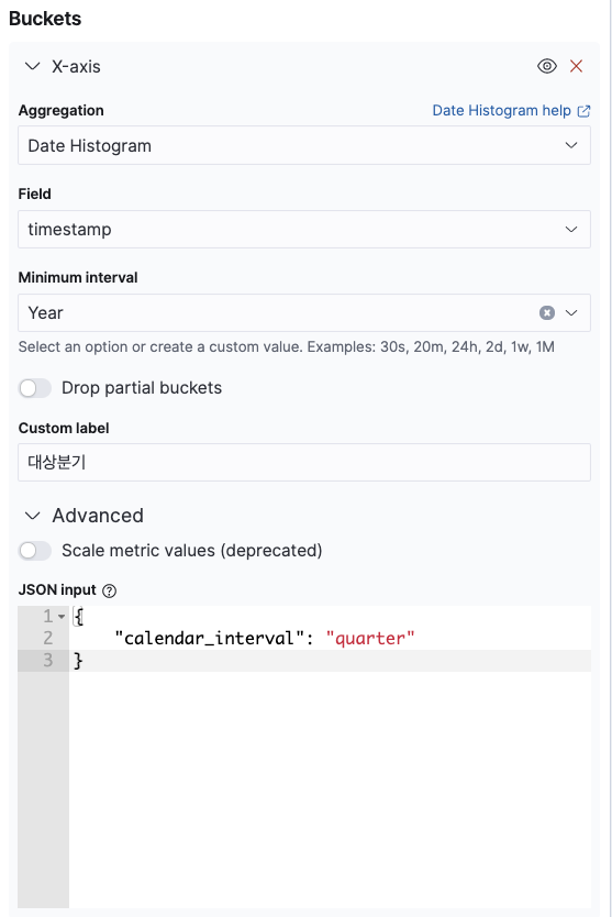

I saw that quarter unit from this link. Date histogram aggregation | Elasticsearch Guide [7.12] | Elastic
Have I understand incorrectly? because the values come out with quarter interval as I expected.

I stand corrected that quarter and 1q are valid calendar intervals, but you can't do 2q or 6M because the calendar intervals can't be multiplied.
