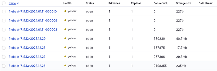

I have run the procedure and I could see as below when compared to yours in previous post.
Latest from my test instance as below.
GET filebeat-7.17.13-2024.01.09-000006
  "filebeat-7.17.13-2024.01.09-000006" : {
    "aliases" : {
      "filebeat-7.17.13" : {
        "is_write_index" : true
So now if you configure logstash output as I suggested...
Logstash will write data to the write alias filebeat-7.17.13 (which points to the concrete index), and your ILM, rollover and delete should work per the policy...
In order for ILM to work... the data needs to be written to the write alias...

Hi Stephen,
ILM is working as expected in the test environment and thanks for your guidance on the same.
I am planning to implement the same in the production system today. Currently I came across with the below observations.
