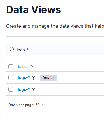

I am working on shrinking spaces into one space in Elastic. I been able to move dashboards from different spaces into one space, the issue is that I have now duplicate data views.
For example:
So the simple answer is delete the non-default one. The issue is that it contains relationships to dashboards/discover session.
How can I ensure that I can replace the data view on the discover session without it being broken? In other words, replace non needed logs-* with the logs-*(default)

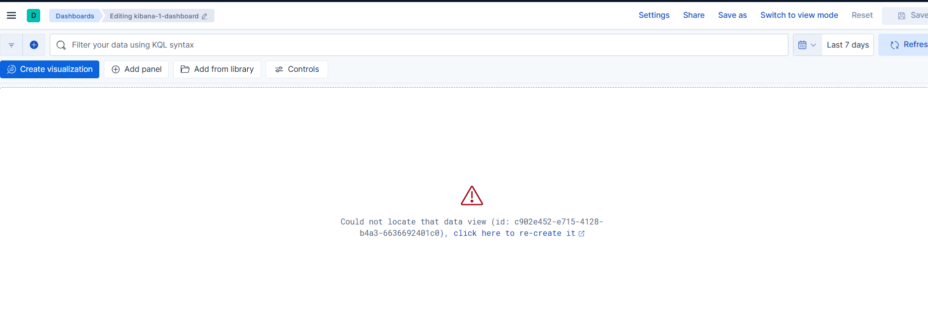

I tried to reproduce similar usecase by deleting the underlying dataview & see below error :

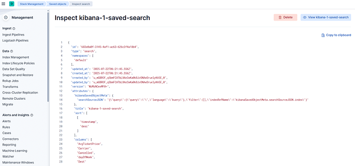

Now since the dataview is deleted , you can recreate the search on the available dataview & link that to the dashboard. To find what was there in the old search, you can check & try to inspect the object to see what was query/columns used to create the saved search.
Thanks!!
I would say that's the best option I have. It should be a way to just reselect the data view, if the saved search's data view is deleted.
