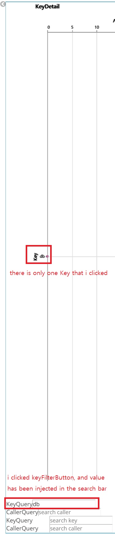

in graph, i have to using 2 Search bars.
the problem is, search bar in screen is duplicated.
and when i clicked both '@callerFilterbutton' and '@keyFilterButton', the button's values(datum.key, datum.keys.key) are not injected in this this duplicated bar.
but another one's value is injected like this. (click please)
i clicked '@keyFilterButton', and it's value(datum.keys.key) is 'db'.
as you see, one search bar's value was injected but another one is not.
above 2 search bars are working when i clicked '@keyFilterButton' and when i typing (like 'db')
below 2 search bars are not injected values when i clicked '@keyFilterButton', but it is working when i typing (like 'db')
is this the bug? or my configuration miss?

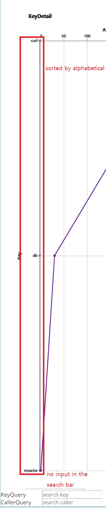

but, Y axes keys are not sorting like this.
first, i didn't clicked any keyFilterbuttons. so, Y axes keys will sorted by alphabetical.
in this case, first key is 'curl', second key is 'db' and third key is 'mcache'.
i clicked 'db' keyFilterbutton. so, graph showing only one Key.
and then i double clicked graph, so graph showing whole keys.
but Y axes keys are not sorted by alphabetical.
and then, when i typed ' ' (space bar) and delete, graph showing whole keys sorted by alphabetical.
this is critical. like following case.
and in using below transform config
      "transform": [
          "type": "filter",
          "expr": "(!KeyQuery || test(regexp(KeyQuery,'i'), datum.keys.key))"
          "type": "collect",
          "sort": {"field": "keys.key"}
how can i fix this?
I think this is a known bug - https://github.com/elastic/kibana/issues/23514 .
