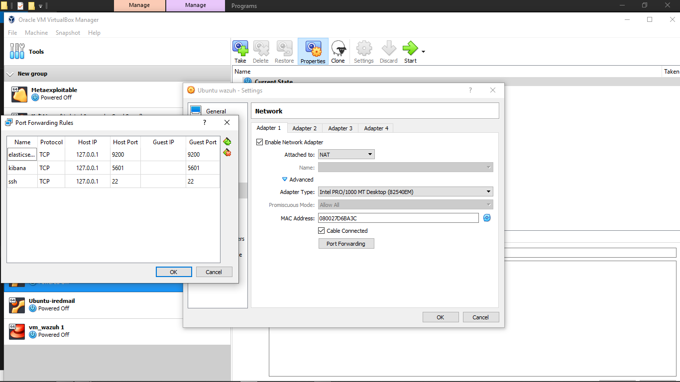

Before
After

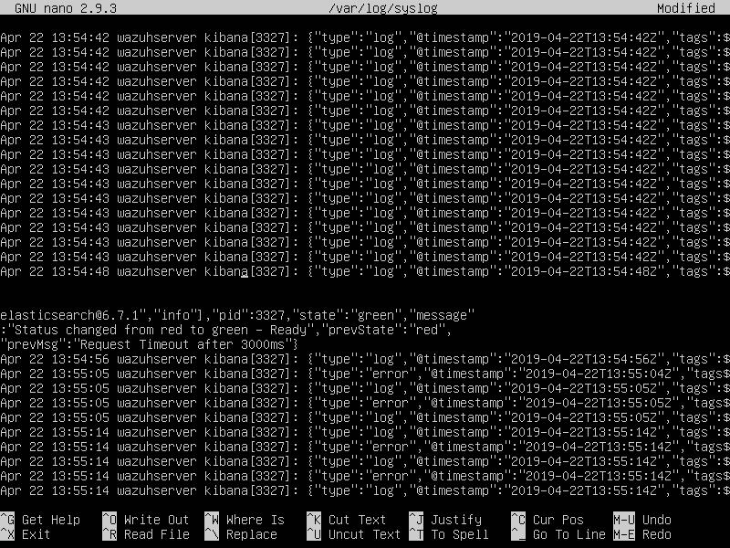

After I changed The Adapter Type to Bridge Mode.I rebooted the VM, and I tried to use curl with port 9200.
it's refused.
as I see, the port 9200 isn't listening..

This suggests that Elasticsearch isn't running. If it's starting and then failing then you'll need to look at the Elasticsearch logs to find out why. If it's not even starting then something is wrong with the way that your system is configured, outside of Elasticsearch's control.
