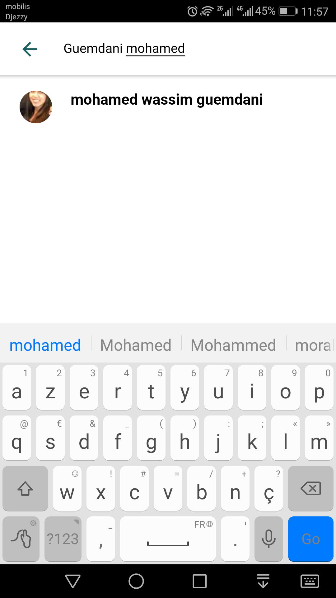

@spinscale, here is a screenshot of my autocomplete feature
no matter the order of terms the engine retreive the same element (document)
