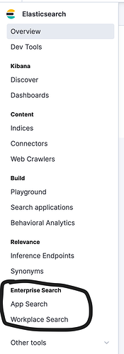

OK, I've spun up the same type of deployment (Elasticsearch, GCP, Belgium) and when I first log in to Kibana I do see Enterprise Search on the left nav bar:
When I click on App Search, after I fill out the form I can successfully create an Engine.

Hmm that's strange, Did you also use Elastic v8.18.2 ? I don't even see the Enterprise search category.
As you can see here, I don't have these options :slight_smile:

Yep, 8.18.2:
This tells me something has to be messed up with your Enterprise Search node, which is why I asked if any errors were logged. It's hard to know what errors to specifically ask for though as I can't reproduce the issue.
