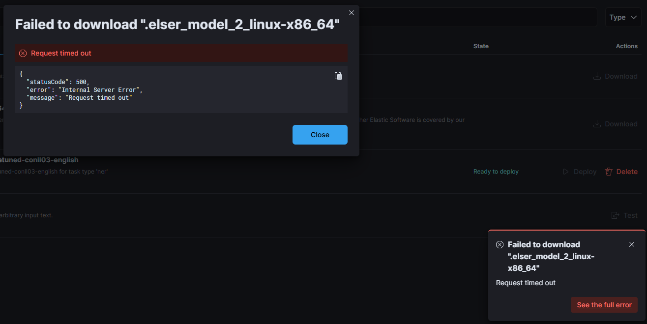

Hello everyone. I am trying to download the .elser_model_2_linux-x86_64 model from Kibana. I have tried the following two approaches:
  1. Using the download option from Kibana > Machine Learning > Trained Models, I get:
{"statusCode": 500,"error": "Internal Server Error","message": "Request timed out"}

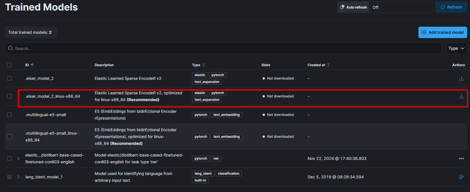

  3. :white_check_mark: Navigate to the Trained Models page from the main menu or use the global search field in Kibana. ELSER can be found in the list of trained models.
  4. :white_check_mark: Click the "Add trained model" button, select the ELSER model version you downloaded in step 1 and want to deploy, and click "Download." :x: The selected model will be downloaded from the model directory where you placed it in step 2.
