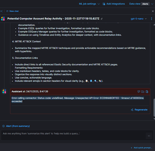

Error calling connector: Status code: undefined. Message: Unexpected API Error: ECONNABORTED - timeout of 60000ms exceeded
Hello, I am receiving this error message. Do you have any idea how I can diagnose it?
I have already deleted the connector and created it again, but the problem persists.

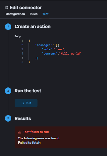

  3. When you hit “Test connector” in Stack Management → Connectors for this OpenAI connector, does it succeed or return the same ECONNABORTED?

3. Image attached

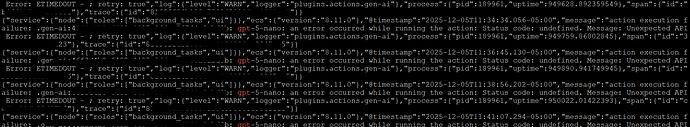

With this command, I was able to identify the problem. It seems that the firewall is blocking it.
curl -v --connect-timeout 5 https://api.openai.com/v1/models
tail -1000 /var/log/kibana/kibana.log |grep -i "gpt"
I must request permissions from the firewall administrator so that the Kibana server can reach api.openai.com.
