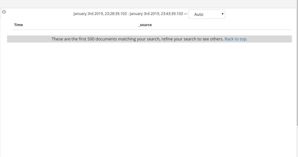

Hey, I am using Kibana 6.4.0 with Elasticsearch and getting the above error. I am using Kibana API to create index-pattern and making timeFieldName as @timestamp . Previously, everything was working fine with the above API requests. But, suddenly I changed nothing and came up with this error and unable to get the logs in the UI! I am unable to figure this out. So, can anybody help me out with the fix of this error and explain what the actual error is?
Also, the logs hit in the UI can be seen as some values image , but the UI is showing nothing.

But yes, Refresh field list inside the Management-Index Patterns worked for me :+1: . But, I am getting the same error for other index-patterns. So, for the fix, I'll have to go inside every index-pattern and fix it, a hectic and several steps process. So, can you explain me what the real problem is so that I can look into it ? And if there are other ways to fix it for all at once or permanently remove this error?
