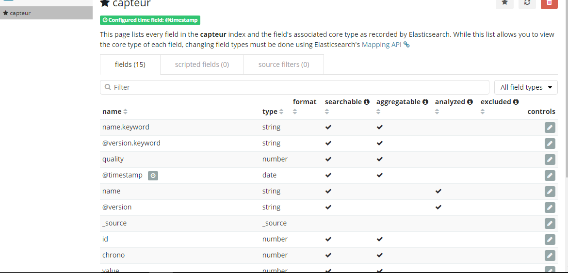

I can read the data from sql server with logstash and elasticsearch but I cann't visualize them with kibana.
Help me please !
