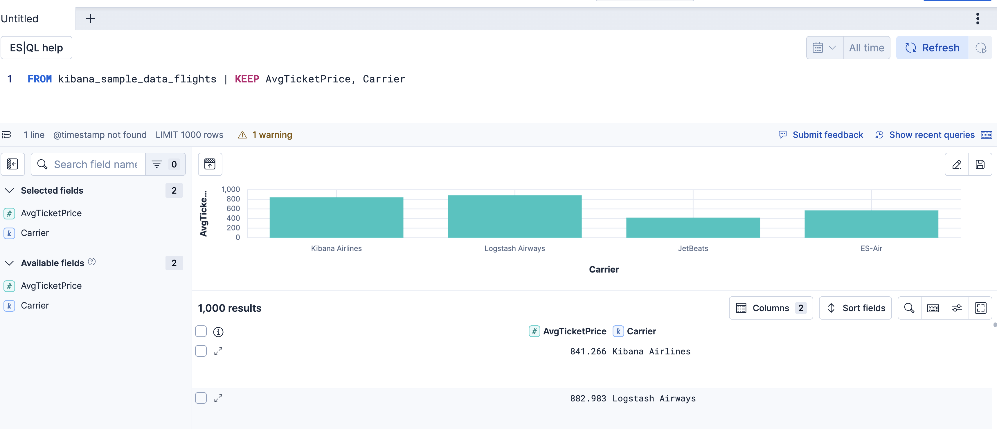

Keep has a different functionality. So if for example you keep one numeric and one string field
then you have a nice visualization depicting this information
If you keep the @timestamp it wont display the histogram following the logic I mention above (stats and keep are rendering a different chart if possible). So trying to detect if the user kept a timestamp and only then display the histogram would require some complex calculations.
