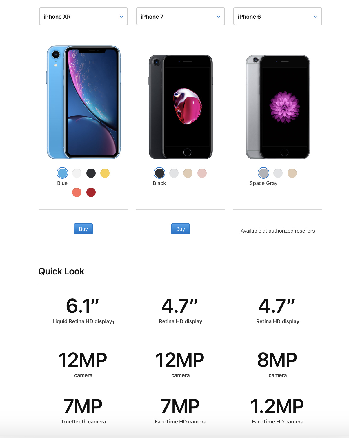

For example, look at this table found on Apple.com.
Notice how you can select an iPhone model from the dropdown, and the column updates to show info pertaining to that iPhone model. What I am trying to do does not include images, but only text. Is there a way I can use the Dropdown Filter element to select a column's name, and it display that column in the Data Table?

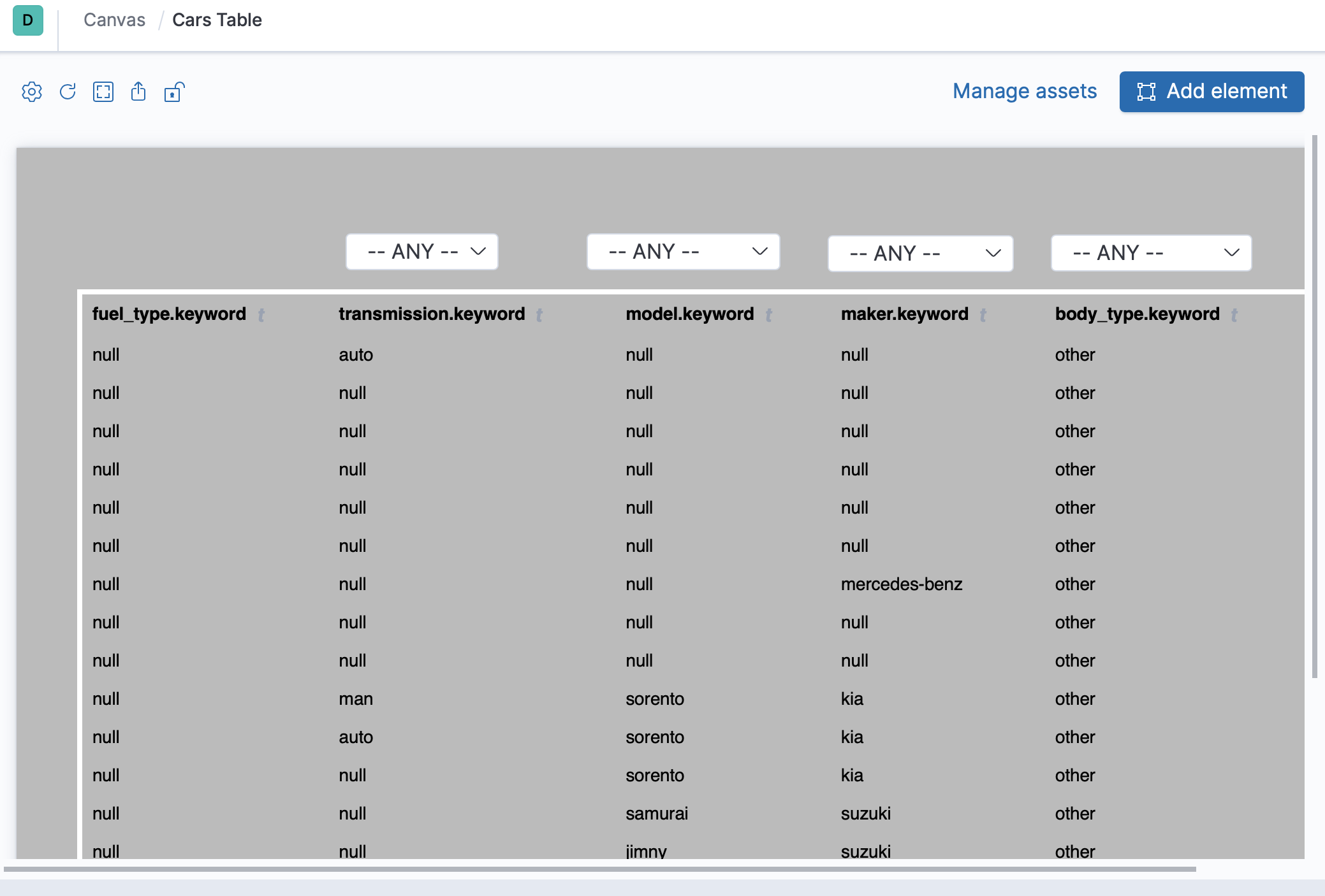

Hi Lukas,
I've attached a screenshot of my CSV file and the screenshot of my Canvas. As you see, I have 16 columns on the CSV file, but for my Canvas I have 5 columns. As you see in terms of design, there are 4 drop-downs on top of 4 columns. I want to be able to switch between the 16 columns in the CSV using the drop-downs in Canvas. So for example, in Canvas, the drop down should give me options of 16 different columns (maker, model, mileage, manufacture_year, etc.), and the column underneath should change and display the data for the requested column. Is this doable?
Unfortunately this isn't currently possible. The drop down filter can only be used to filter rows from your data, not columns.
