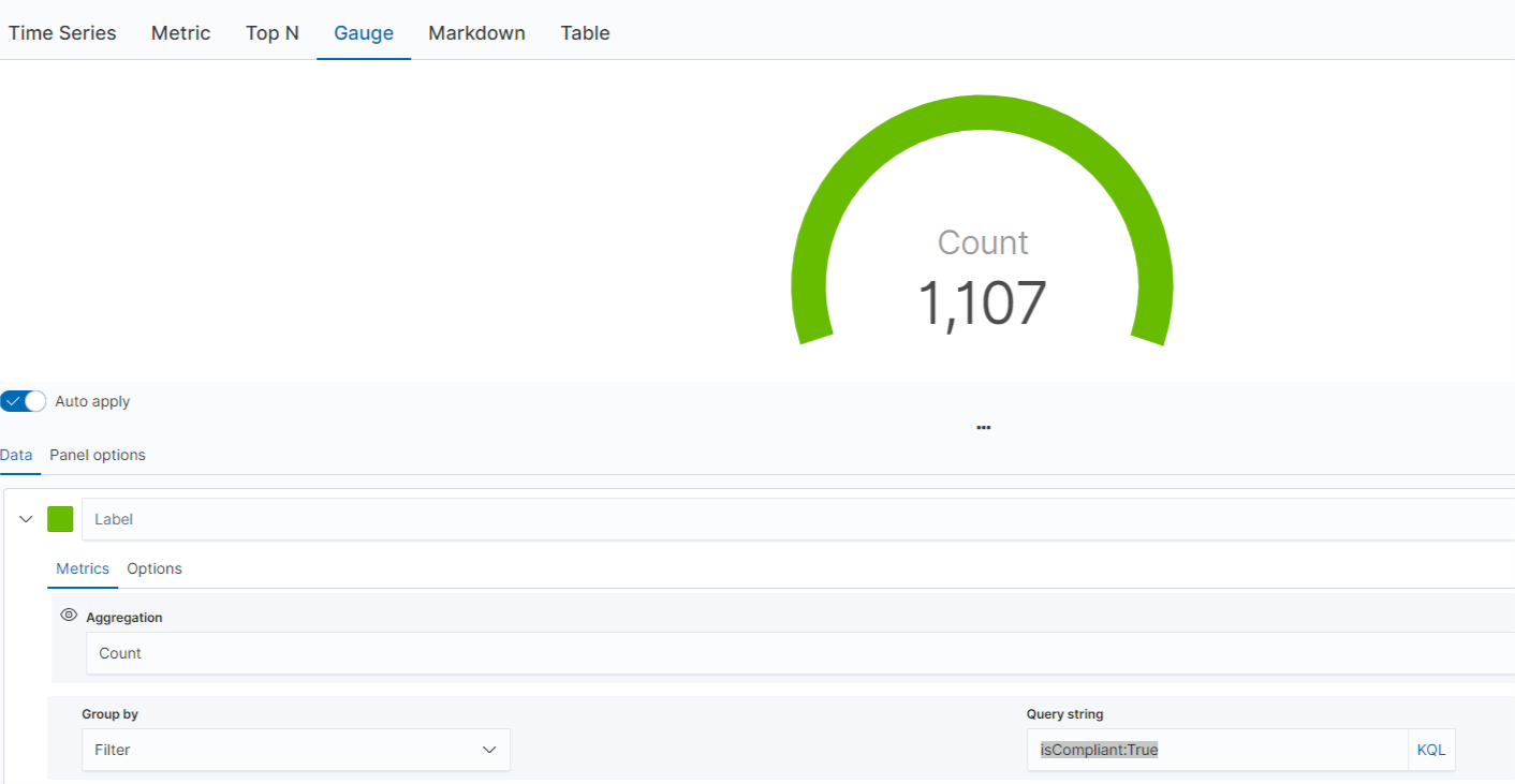

Hi, im indexing some data and I want to know the ratio of documents that have isCompliant as True. I visualized the data as count over time and I see documents.
Then I moved to gauge and applied the filter as grouping
But when I try to use filter ratio with the same filter as numerator, it stays at 0. Even when I choose * as numerator and denominator it stays at 0. (Shouldnt it be 1?)

Got it. Then this should be working. Are you sure you've enabled "Entire time range mode" in TSVB? It wasn't in any of the screenshots.
Yeah, here you go
