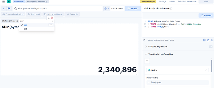

I'm testing out ES|QL controls in a dashboard, but I'm not able to use it as I expected. I've created a control with static values, but using the variable name in the query fails.
According to this documentation that should be possible?

Hello @tallakh
I tried the same for the demo index following the documentation and did not see any problem :
Maybe try to write the query again as i do not see any issues.

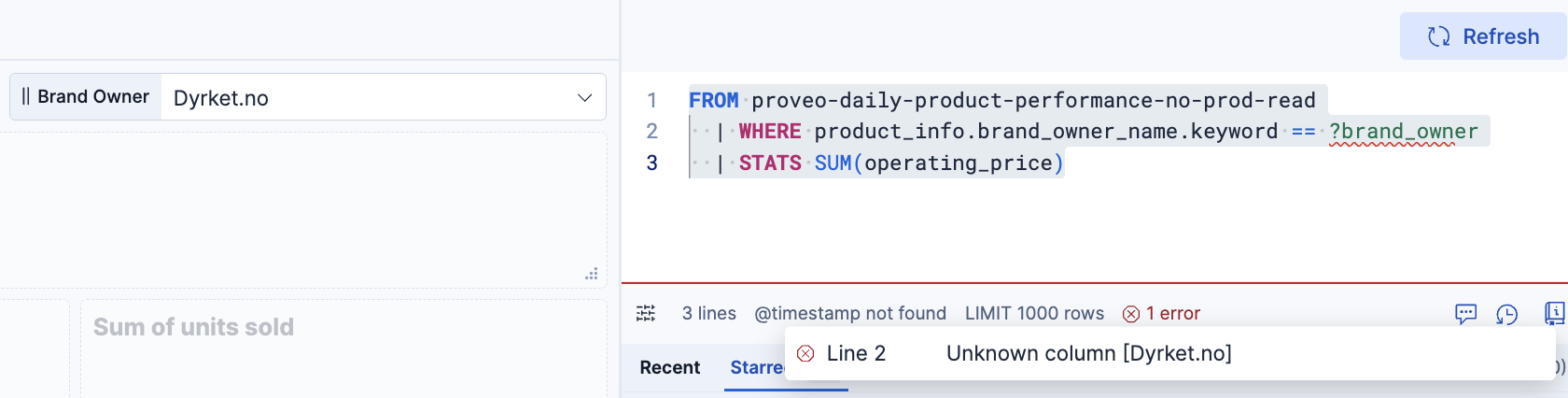

I am trying exactly the same, but I simply cannot get this control to work: It always reports an error with the column (and the value corresponding to the first value of the control).
I have tried different browsers, all with the same outcome. Any suggestions please?
