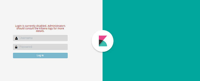

Hi guys, after updating Kibana to version 6.3 I can not access it.
The following error message appears.
Does anyone know how to solve this?

What happened was that Kibana was working normally in the browser, after upgrading to 6.3 unable to access it anymore.
I'm running Elasticsearch and Kibana on a Fedora 28 server

Hmm, so security plugin is enabled (since you see login page), but your kibana.yml doesn't include username and password for internal Kibana user:
#elasticsearch.username: "user"
#elasticsearch.password: "pass"
Can you please set these and make sure they are correct? If that's the reason you should see something like this in Kibana logs: security_exception\",\"reason\":\"failed to authenticate user ....

How do I disable the security plugin? Because before updating kibana this page did not appear
You can set xpack.security.enabled: false in elasticsearch.yml to disable x-pack security plugin.
Even when entering the command, the login page continues to appear
Okay, so we need Elasticsearch and Kibana logs then, otherwise it's really hard to say what's the reason.
Can you share those?
Could you tell me where the logs are?
I guess you didn't configure logging-to-file, so logs should be output to console/terminal window where you run elasticsearch and kibana. So this content should be enough to debug the issue.
