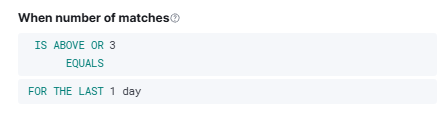

To give more details, I check every 30 seconds, and Notify: Only on status change (i have tried them all, all same result) I have my index and my Elasticsearch query is :
  "query": {
    "bool": {
      "filter": [
          "match": {
            "my_field": "Danger"
When I test the Query, it return 10
And in When nulmber of matches I put, is above or equals 3 for the last 1 Day
In the When number of matches help it say : "The time window defined below applies only to the first rule check" but I need it to check: above or equals 3 for the last 1 Day everytime (every 30 seconds!)
Thank you very much

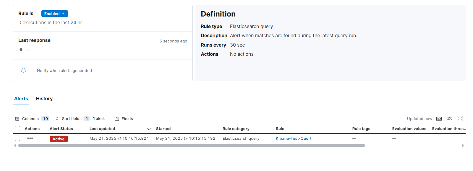

Thank you @elastic_interogation for sharing the details.
I have tried to create a test rule & do not see any issues :
It seems you have enabled below because of which it gets recovered if there are no new records & count of records remains same for that duration, if you uncheck it , the alert will remain Active
Thanks!!
