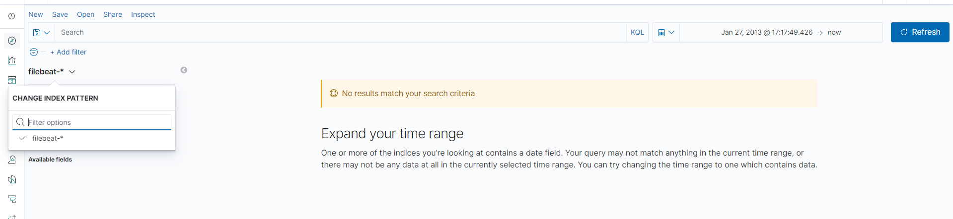

Hello
I'm following this tutorial, where you ingest some Apache logs with FIlebeats into Elasticsearch to visualize them in Kibana.
This step-by-step set of instructions will walk you through setting up an Elastic Cloud account, creating and securing a Elasticsearch cluster, importing data, and visualizing it in Kibana.
I follow all the steps and none fails, but when I have a look at the index pattern there is no data, even changing dates.
Could someone help me? I'm doing this from Ubuntu 18.04.
Thanks in advance.
