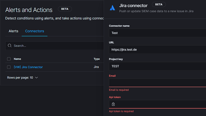

Hi,
to create a Jira connector in Alerts and Actions, Email and API token are required fields. I can't find any information, how to configure this in Jira. Do I have to define an application in Jira ? But no email is necessary for an application in Jira.
Can anybody help or provide a link to the documentation for this Jira connector ? Thanks in advance .

Unfortunately not. The configuration for Watcher is fine and we use it, but if you look at the mandatory fields for the Jira Connector in the new Alerts and Actions framework, these fields Email and API token are what I have a problem with.
Hi, @norgro2601!
If you have a cloud instance your account is email-based and you can create API tokens from your account's management page. You can read more here: https://confluence.atlassian.com/cloud/api-tokens-938839638.html
If your instance is self-hosted API token authentication is not supported. Nevertheless, you can put your username in the email field and your password in the API token field and the connector should work without issues.

Hi, @christos.nasikas,
unfortunately this doesn't work. I've entered the credendials and I can save it, but when I reopen the Connector settings, the entries are gone. I've upgraded the instance to 7.8.1 tonight to have the latest changes available. Could it be a problem, that the usernames we use are the email addresses and that misleads in the code ?
