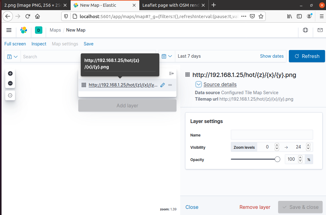

But in Kibana the map doesn't show, it seems to have no error messages:
my configuration file :

I tryed with 'map.includeElasticMapsService: false' first, with the same result witch is this :
I tried to manually add a layer with the same result.

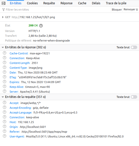

Can you open the developer tools and check in the network tab whether your browser is attempting to download tiles from your configured server?
It's possible the request is blocked by the CSP (Content security policy) of Kibana - if that's the case it should be evident from the errors in the Network tab.
It seems to be a policy error as you said :
the network tab is all green :
What do i need to do to fix it ?
It is for an offline demonstrator so i needn't strict security rules.
Thanks a lot.
The error message indicates the issue here is your custom tile map server - it needs to set the cors header so Kibana is allowed to download the tiles.
It works in the "sample_leaflet.html" example from your original post because the websites loaded via "file://" are handled differently.
How to set the cors header depends on how your tile server works - the tutorial you linked uses apache, here is a tutorial how to enable cross origin requests: https://enable-cors.org/server_apache.html
