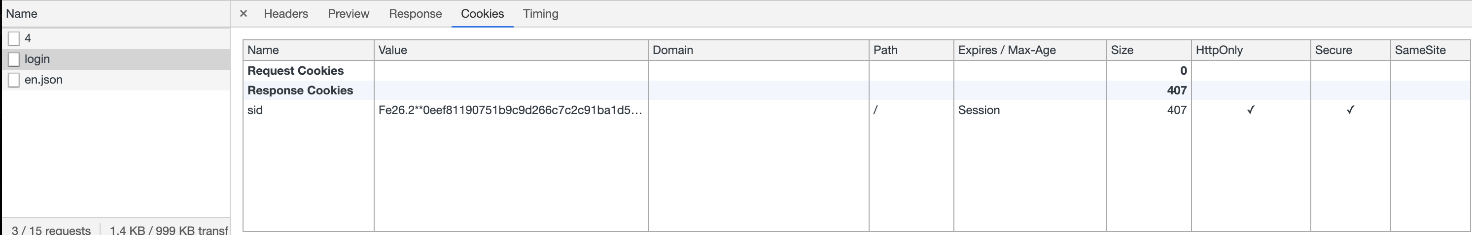

Also, I have also tried another alternative using this post:
If you refer to the screenshot, I was able to get some JSON response. But i am not getting the cookie.
Do I need to make any changes in elasticsearch.yaml or kibana.yaml files in order to get the cookie? If i get the cookie. I can store it in my browser. But, Will it work after getting the cookie?

The cookie comes in a response header, not in the body of the response, you need to examine the headers in postman
Hello @ikakavas,
I am able to call the Kibana Api and can see all the response headers in the network Tab.
Also, I can print all the headers in the console window. But, except ['Set-Cookie']. Is it because of http -only?
Please, may I know how to grab the cookie?
