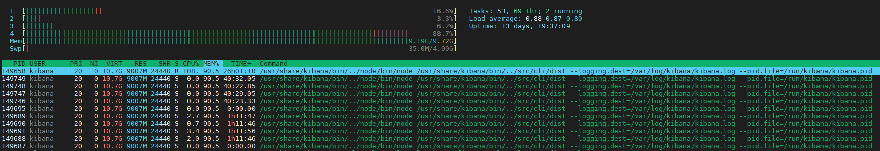

Looking at htop, this is primary kibana now:
Secondary kibana:
Third kibana:
