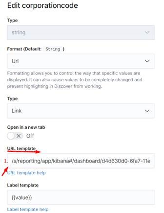

I have a question regarding Kibana URL templates for fields in the index.
  1. I have used relative path for the below URL template.
    1
  2. On local environment it is replaced with http://localhost:5601/s/reporting/app/kibana#/..... Which is expected.
  3. On my DEV and QA environment also it is replaced with http://localhost:5601 instead of http://dev.somedomain.com:5601 which is not expected.
  4. I have my DEV and QA environment Kibana on some domain (DNS name) and everything is working fine except this URL template.

So is there any way that this Origin value can be taken from Kibana.yml file, so that in each environment we don't have to change it manually.
Also I have noticed, that in DEV environment after promotion using snapshot and restore, if I manually change the URL template to give full path with http://dev.somedomain.com:5601 , the links in dashboards works as expected, but the query in Dev Tools still returns the same origin value as localhost.
