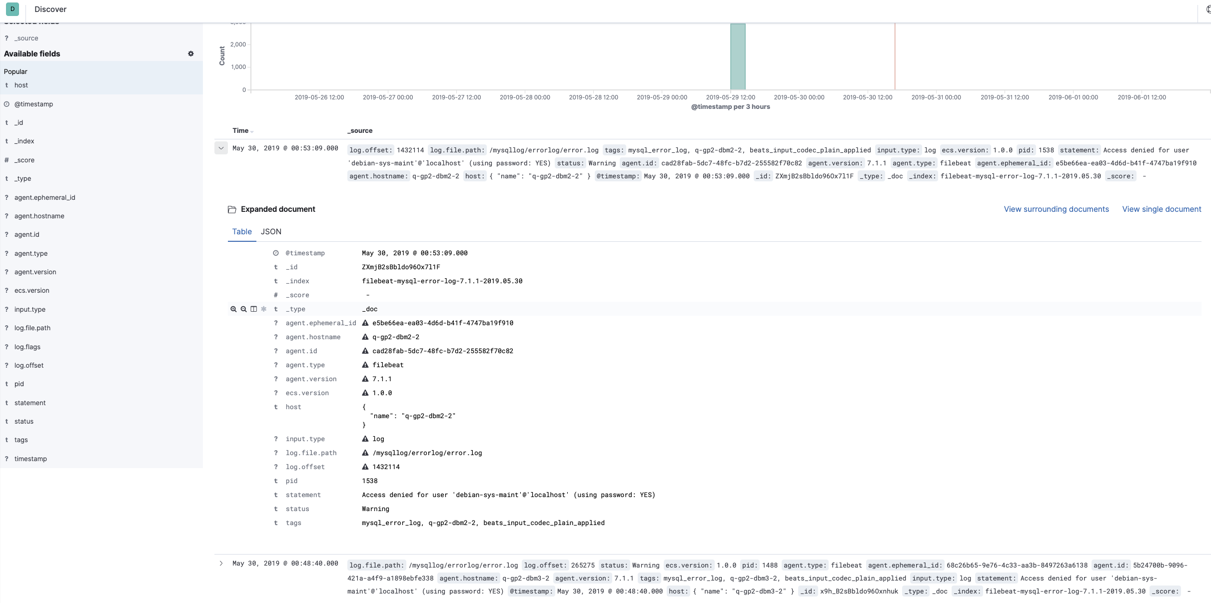

I can see the data but when trying to query on it through discoverer
So, Discover is showing you the data you expect?
Through kibana visualizations it does not seem to have access to different terms like host.name.
Are you trying to use Visualizations which existed in 6.x, now in 7.1.1 and running into issues; or are you having issues creating new visualizations?
Yes, discoverer is showing the data I expect.

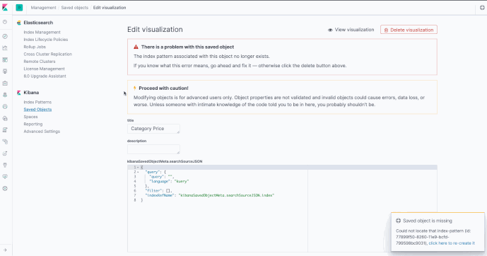

I tried to use the visualizations that were brought over after the upgrade and that did not show any data. I then tried to create a new visualization from scratch but I am getting the same issue. I tried dropping the index pattern and re-creating it but that didn't help either.

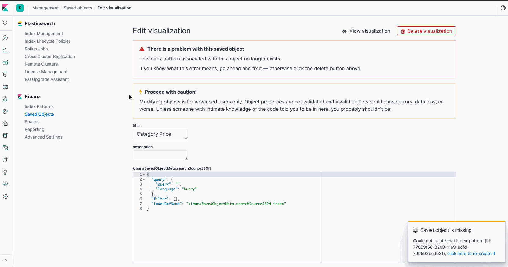

If you've deleted the index-pattern which the various Visualizations are associated with, when you go to view the Visualization itself in Visualize, you'll be redirected to the "saved object management" screen:
Are you seeing this behavior? If so, I can walk you through how to address it.

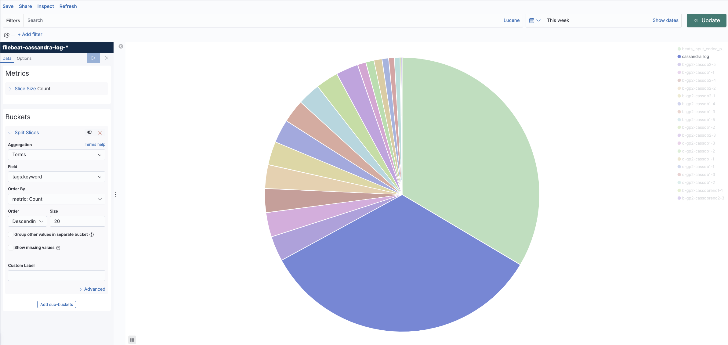

If you're primarily concerned about the ability to create new Visualizations, would you mind posting a screenshot of what you see when you go to create a new visualization?
I'm primarily concerned with the visualization. I'll upload some screenshots. I have the data but it just doesn't seem to want to show via the visualization.

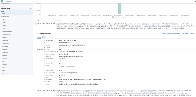

ok, i'm trying to do another visualization and i can see the data in discoverer but not when trying to display in the visualization. see pictures below.
host.name will not display anything
never mind .... i ended up deleting my old index patterns and recreating them and i can see the new fields.
