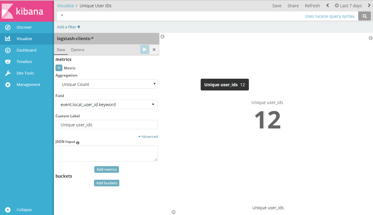

Then in these two visualizations, these documents don't appear to be part of the visualizations and I don't see anything that is keeping them filtered out.
In the above visualization, note how Feb 1st doesn't have any user ids present, when they appear to be present on the first screenshot.
Second visualization, would expect this count to be at least 20, if not higher.
The only thing that I can think of is ts the field in visualizations are ".keyword" -- I've tried to google this and not sure what it means and why it is appended to the end of the field.

Good eyes on catchingTime vs event.t @warkolm ... They are identical however so I don't think that has solved my issue. (I thought maybe we had screwed it up though so you got me excited)
I wanted to confirm changing the date in the visualizations has not solved the problem...
As you can see from the other reply, the times are the same in both fields.
