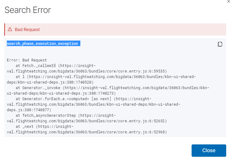

Dear Joe,
I did, but most of times it prompts the same error message while 1 out of 10,
it returns with an error message: "search_phase_execution_exception"
Thank you for your help
It might be necessary to clean the browser cache and open Kibana in a fresh window - otherwise it's possible the overly long URL stays around and the browser tries to navigate there again.
The search execution is a different problem, hinting at a problem with the query - maybe there's a typo in your json input? I would recommend trying to fix the URL problem before tackling this issue.
Thank you Joe,
I clean the browser cache and open Kibana in a fresh window, then long URL problem solved.
However, it then becomes search execution.
I can confirm there aren't any typo in my json input.
I try to trim down the filter to every 750items, it works fine. But when the filter items increased to more than 1000, then it returns with an error "search_phase_execution_exception".
Thank you
sample of json input:
"query": {
"bool": {
"should": [
{"match_phrase": {"REMOV_PART":"4063-18167-1"}},
{"match_phrase": {"REMOV_PART":"4063-18139"}},
{"match_phrase": {"REMOV_PART":"VR4100-03"}},
{"match_phrase": {"REMOV_PART":"VR4100-04"}},
{"match_phrase": {"REMOV_PART":"AE1410BA1"}},
{"match_phrase": {"REMOV_PART":"1218-100"}},
{"match_phrase": {"REMOV_PART":"VD3820"}}
"minimum_should_match": 1
Can you try to run the query against Elasticsearch directly from dev tools? This will give you the specific error message. I guess you are hitting some Elasticsearch limit that might be possible to increase via config setting, but I'm not sure which one
Dear Joe,
It returns with the followings, many thanks:-
reason: {type: "query_shard_exception", reason: "failed to create query: maxClauseCount is set to 1024",…}
caused_by: {type: "too_many_clauses", reason: "too_many_clauses: maxClauseCount is set to 1024"}
index: "wilco__insight-val__standard__v2"
index_uuid: "qDWWRbMRTuiUn0NPOXtRSQ"
shard: 0
grouped: true
phase: "fetch"
reason: ""
type: "search_phase_execution_exception"
reason: "error while executing search"
type: "status_exception"
error: "Bad Request"
message: "status_exception"
statusCode: 400
That's it - you should be able to bump it using indices.query.bool.max_clause_count: https://www.elastic.co/guide/en/elasticsearch/reference/current/search-settings.html
