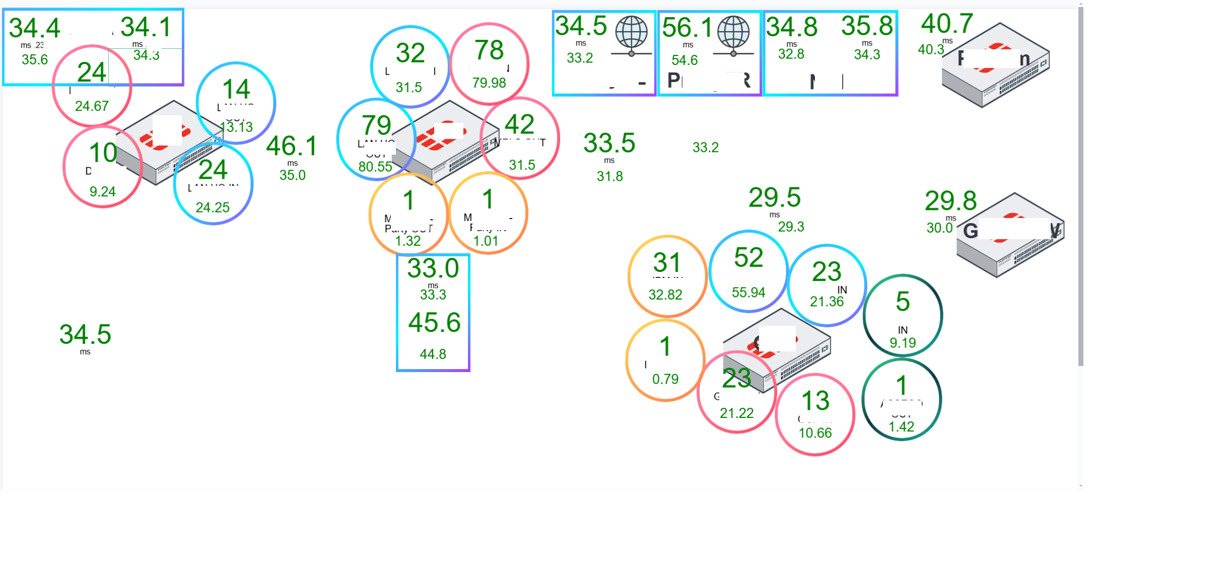

Results
Ping "Expression" Code:
kibana
| selectFilter
| essql
  query="SELECT monitor.duration.us/1000 as latency_ms
FROM \"heartbeat-*\"
WHERE monitor.ip = 'SOME_IP_10.10.10.10'
    AND \"@timestamp\" > NOW() - INTERVAL 5 MINUTE
| math "mean(latency_ms)"
| metric
  metricFont={font align="center" color={switch case={case if={lt 100} then="green"} case={case if={all {gte 100} {lt 200}} then="yellow"} case={case if={gte 200} then="red"} default="black"} family="'Open Sans', Helvetica, Arial, sans-serif" italic=false size=48 underline=false weight="normal"} metricFormat="0.0" "ms"
| render css=""
Utilization "Expression" Code:
kibana
| selectFilter
| essql
  query="SELECT *
FROM \"fortigate-*\"
WHERE interface.ifName = 'port1'
    AND host.ip = 'SOME_IP_10.10.10.10'
    AND \"@timestamp\" > NOW() - INTERVAL 5 MINUTES"
| math "mean(interface.inMbps)"
| metric
  metricFont={font align="center" color={switch case={case if={lt 700} then="green"} case={case if={all {gte 700} {lt 800}} then="yellow"} case={case if={gte 900} then="red"} default="black"} family="'Open Sans', Helvetica, Arial, sans-serif" italic=false size=48 underline=false weight="normal"}
  labelFont={font align="center" color="#000000" family="'Open Sans', Helvetica, Arial, sans-serif" italic=false size=18 underline=false weight="normal"} metricFormat="0" "LAN HQ IN"
| render
  css=".canvasRenderEl {
    position: relative;
    border-radius: 125px;
    padding: 25px;
    background: transparent;
.canvasRenderEl::before {
    content: \"\";
    position: absolute;
    inset: 0;
    padding: 5px;
    background: var(--dynamic-gradient, linear-gradient(145deg, #4facfe, #00f2fe, #a742ff));
    border-radius: inherit;
    -webkit-mask:
        linear-gradient(#fff 0 0) content-box,
