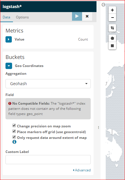

No Compatible Fields: types: geo_point
I am following practices below;
I am using both Elasticsearch & Kibana version 6.2.1
I followed instructions as below;
But, I am getting following error:
No Compatible Fields: The "logstash*" index pattern does not contain any of the following field types: geo_point
Am I missing something here? How can I resolve this error?

And when I try to create Coordinate map by following example, I am still getting same error.
