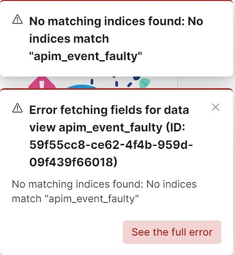

Hi all, I want to use ELK to monitor the WSO2 API Manager and I have done configurations here
https://apim.docs.wso2.com/en/latest/api-analytics/on-prem/elk-installation-guide/
but I got an error when connecting to kibana and trying to view the dashboards
and this is my configuration:
