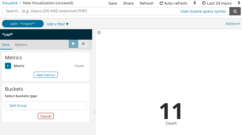

Grouping by ID is working, as I see rows, but my Count metrics are giving me 0s:
But if I create a basic Metric and only apply that same filter (path: "*/reject") I can see that there are 11 documents out there that match the filter:
What'd I do wrong?
Would you mind creating a bug for this? Even without using the filter, I'm not seeing any results unless I adjust the interval to be larger than the timespan and then tell it to not drop the last bucket.
