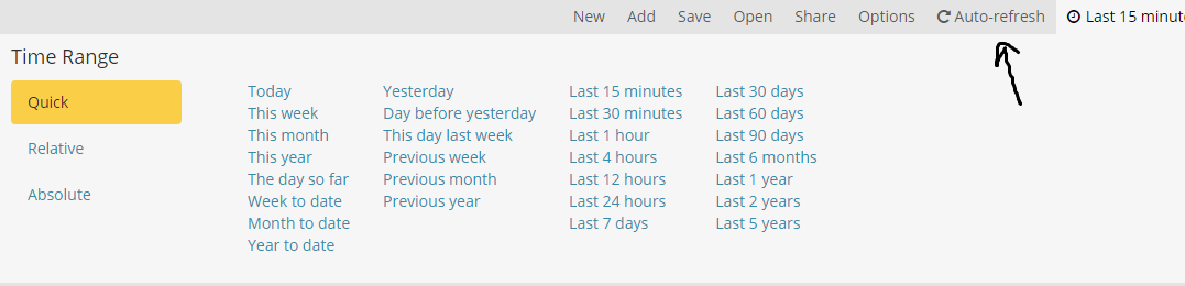

Hi,
Which Kibana version are you using? On the one I'm using (5.2), you can stop the refresh interval by pressing the pause button and then reactivating by selecting the play button at the very top of the dashboard:
Otherwise, if you click on the last x minutes tab, the autorefresh tab pops up on it's left, and you can select a new refresh interval
Thanks @annizaki ,
I m using 5.2.2, 5.4.0 and 5.5.0.
Ok with the auto refreh button in time picker I missed. It's work.
