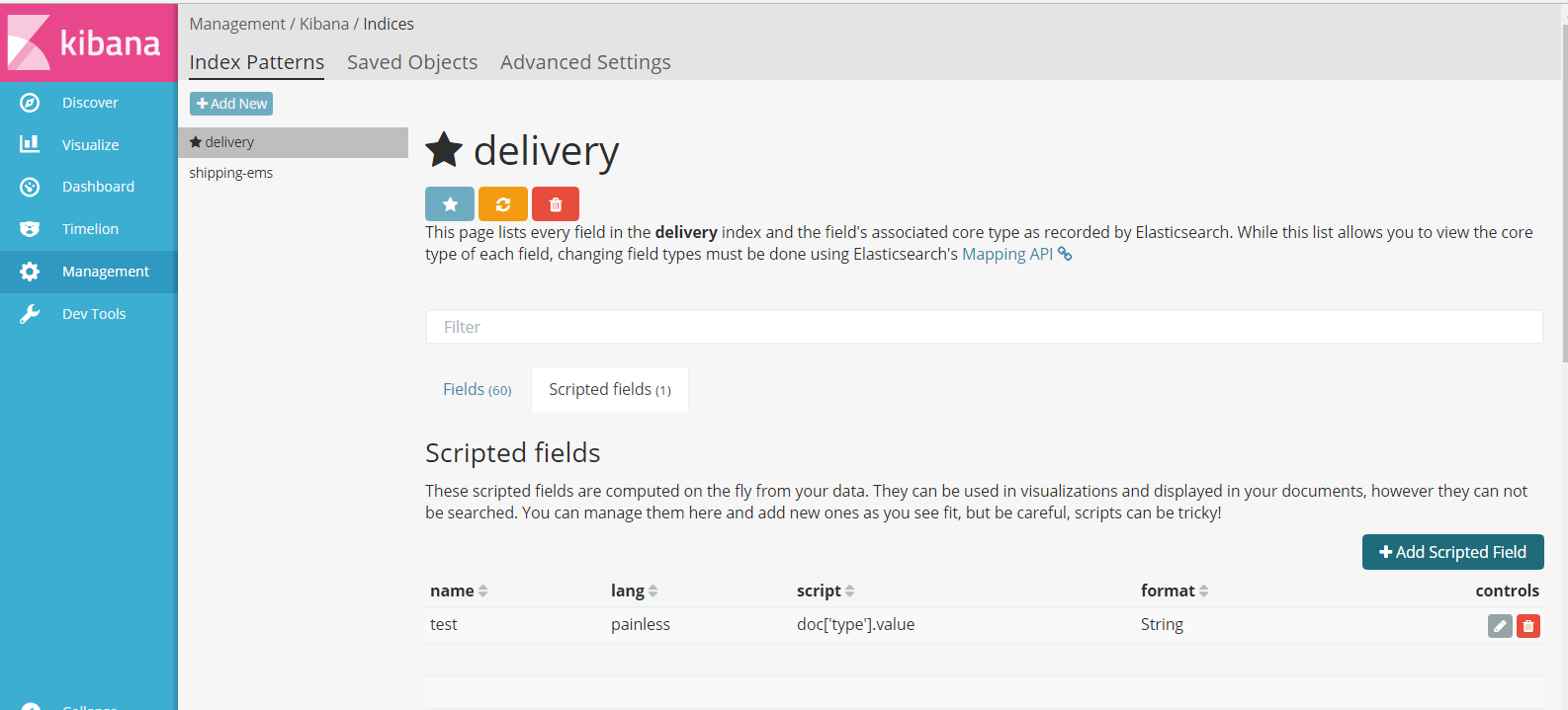

I am trying to replicate a field using the scripted field in Kibana (5.0 GA).
However, it causes below error when I search.
Below is my scripted field definition.
"type" is the filed automatically generated by filebeat so it is a string type.
I have set security level to true but made no difference.
script.inline: true
script.stored: true
script.file  : true
Do I have any grammer mistake in the painless language?
