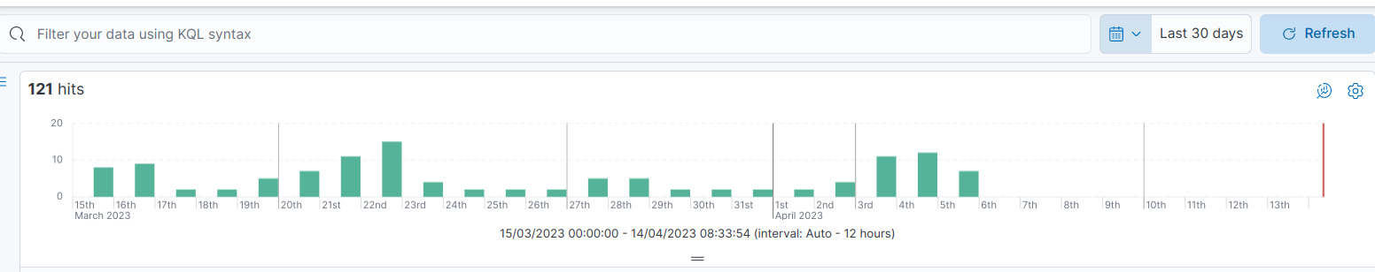

As you can see, the current_position of the Index is at timestamp 1680739200000 Which, converted, refers to Thursday, 6 April 2023 00:00:00.
The "index_pattern": "kong", which my my rollup job is looking for, has data for today (2023-04-14):
Index Kong Discover View:
(There's a lack of data between 2023-04-07 and 2023-04-13, don't worry about this.)
As my job is running once per minute, it's supposed to have the data for today. But this is not happening.
My rollup job Discover View:
As you can see, there's no data for 2023-04-13 and 2023-04-14.
