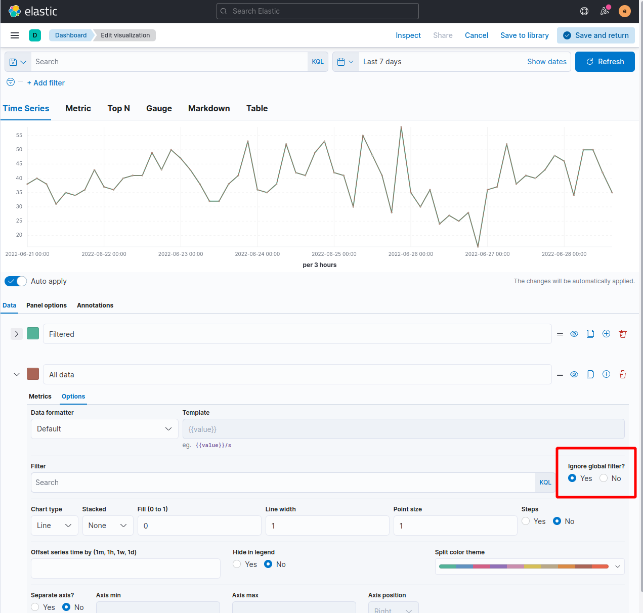

The tricky part is where you want to dinamically set up a filter that excludes data from a panel. If your value was static then both Lens and TSVB can be configured to have layers with your custom filters.

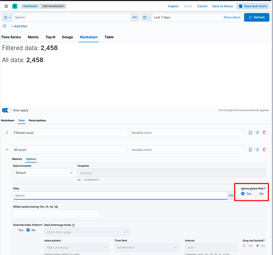

If you can live with showing all the data and then have another layer that shows only the filtered data you can use TSVB for that since it has a setting to ignore the global filter. Then you can have a base layer that ignores the global filter and a regular layer that will show your filtered data. TSVB can generate charts and metrics so you can have different representations.
Peek 2022-06-28 17-57
And then on the TSVB data configuration for both the markdown and the line chart panels you have the bottom layer ignoring the global filter
