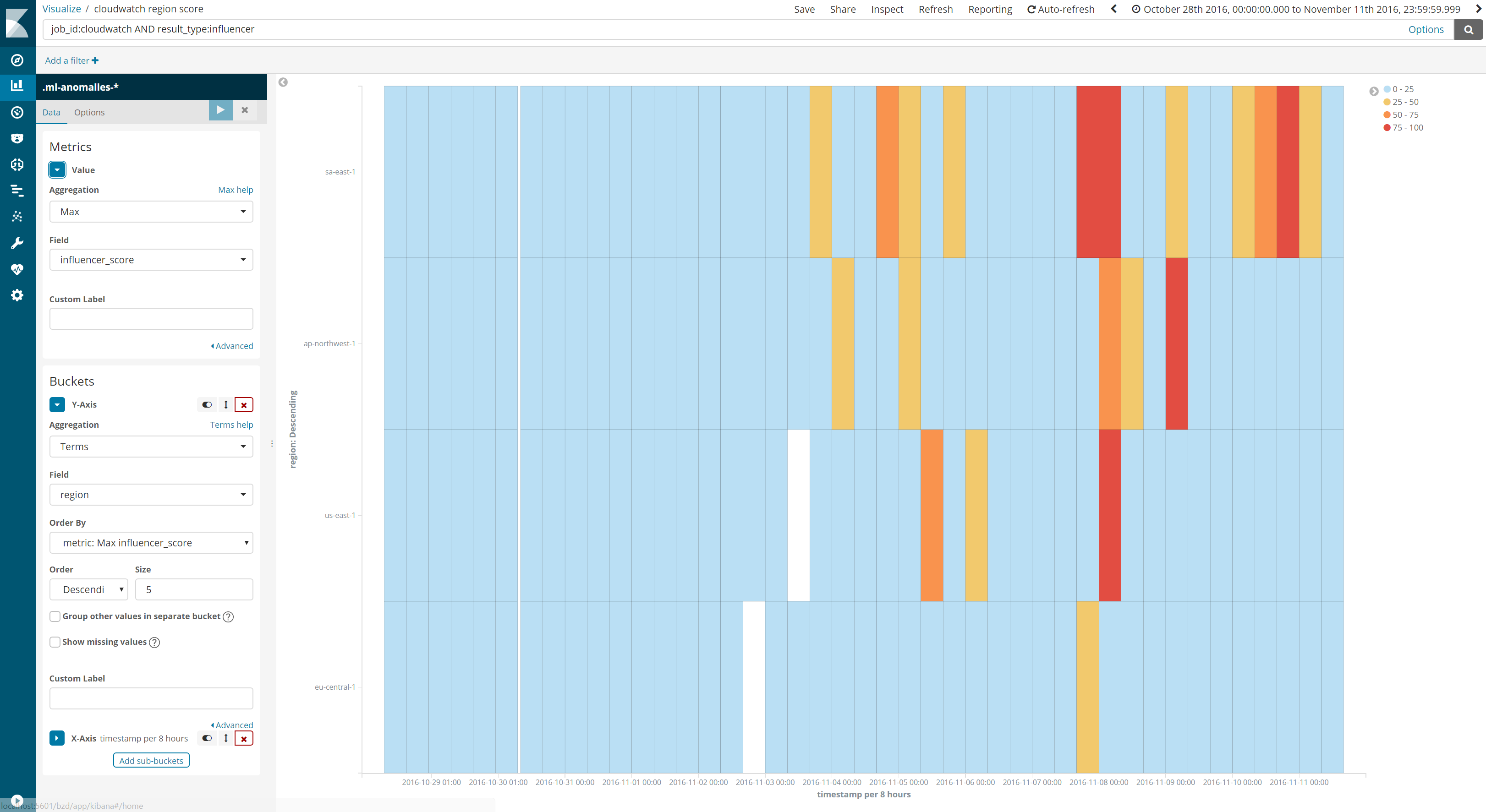

To recreate the 'view by' swimlane, you want to query for result_type:influencer and then plot max influencer_score as the metric. To split by e.g. product, add a terms aggregation for the y-axis, splitting by product, ordered by max influencer_score, and use a Date Histogram for the x axis. You can then customize the colors for the Heat Map using the legend control to the right of the visualization.
Here is an example of one I created for a multi metric job, where I am splitting by a region field:

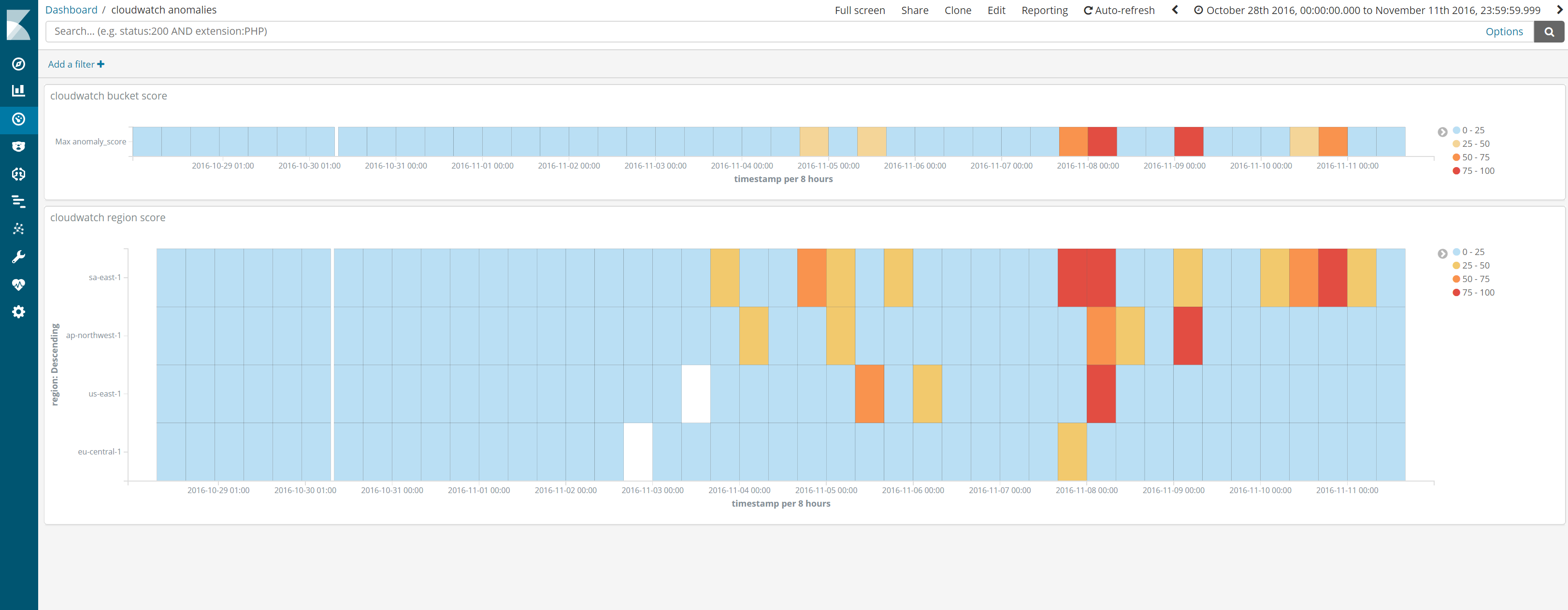

To recreate something similar to the Overall timeline, you should query for result_type:bucket and select max anomaly_score as the metric. Just use a Date Histogram for the x-axis, and no need to split the data.
Here is what the visualizations look like when added to a Kibana dashboard:
which compares well to the ML Anomaly Explorer:
