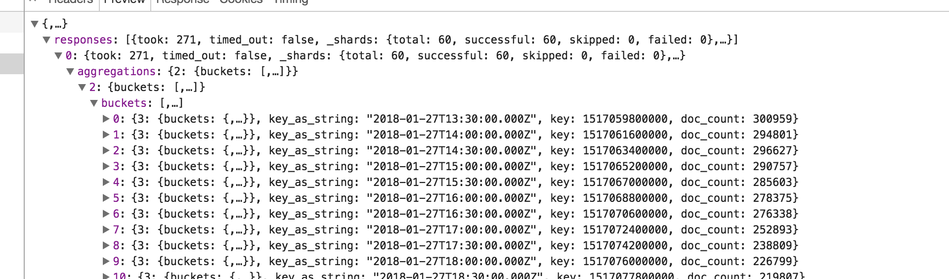

For example, clicking search on the visualistion shows this in console:
You can see the search/json seemed to return ok:

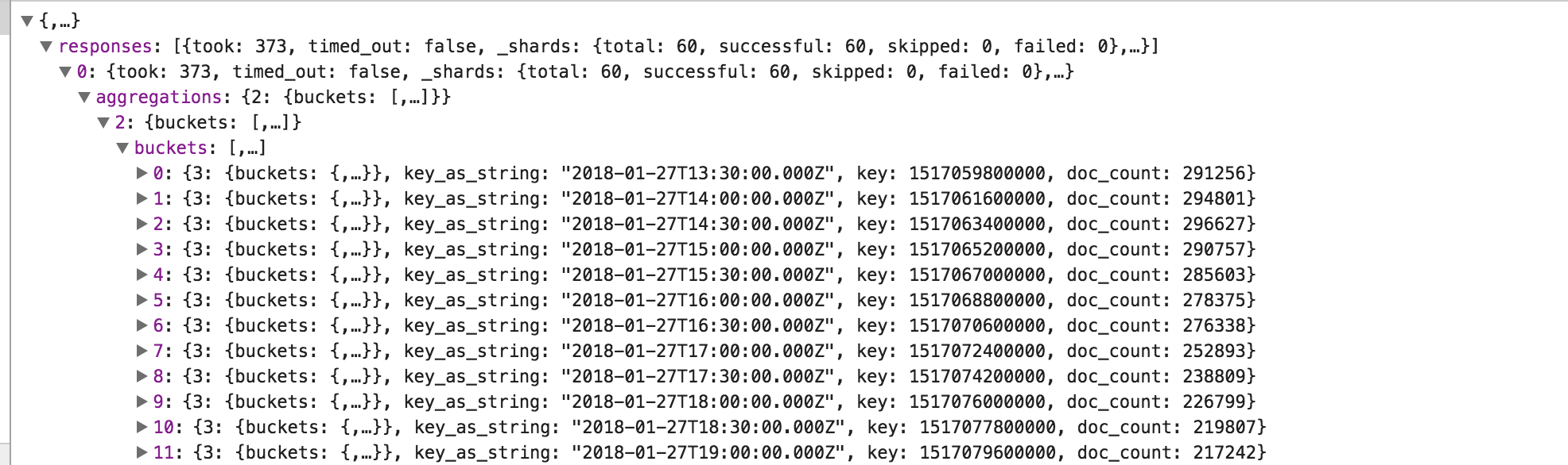

If I toggle the filter from "Term" to something else, then back to "Term", it's fine:
33
Can't really see any difference in the response!:
So I started to look at the differences in the stored JSON between an "unfixed" and "fixed" visualisation.
