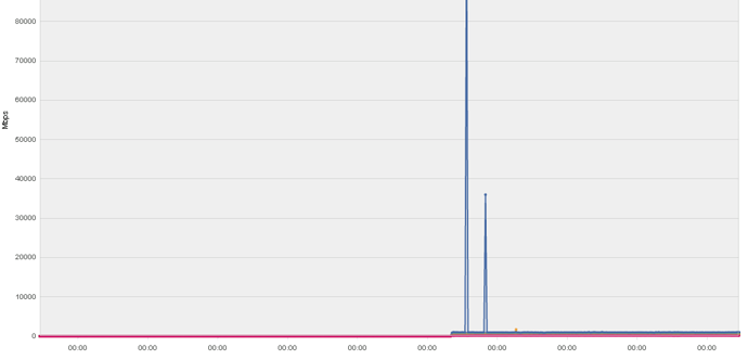

When using "auto", Timelion shows only the hour and not the date for long spans of times such as now-10d to now is there any way to fix this?

If you use now-7d and small time spans, it happens.

Is the screenshot from a Dashboard, in the Timelion chart builder or in a Timelion sheet?
The screenshot is from a kibana dashboard but it does happen as well in the timelion builder and the kibana timelion builder (it is saved to support kibana queries)

I'm using Kibana 5.5.0 and I've tried last 10 years and last 5 years. I've tried various selections of the bucket interval sizes, and even tried a few different data sets I have. I used some splits and label regexes and Y-Axis labels. I couldn't get this to happen in the Timeline builder, trying with fullscreen as well, or embedded in a dashboard.

It happens with small spans, like now-10d to now or 1 week. With bigger spans it shows the dates
Oops, my mistake!
I tried with some historical data, and used absolute times in the time picker. I actually do see this now, and I'm still using Kibana 5.5.0.
I could get it to happen when I'm looking at a time window of 2-5 days, but at 6 days and higher, I don't see it.
It looks like a valid bug, and I didn't see any record of it in the Kibana Github, so I filed a bug report for it: [Timelion] X-Axis shows times but not dates in the X-Axis for certain time picker ranges · Issue #13065 · elastic/kibana · GitHub
