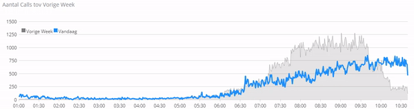

I have a Timelion visualization which works fine with auto refresh when i set it to 4 hours. When I set the timeframe to Today So far, when it refreshes the timelion graph, it comes up with different graphs which isnt correct. See the gif here how it looks.
timelion
My timelion expression looks like this:
.es(offset=-1w, index="servicedata*",timefield="datum").label("Vorige Week").lines(fill=1,width=0.5).color(gray), .es(index="servicedata*",timefield="datum").label("Vandaag").color(#1E90FF).legend(columns=3, position=nw)
