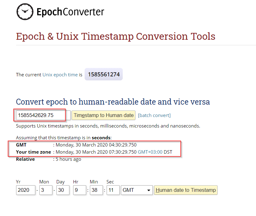

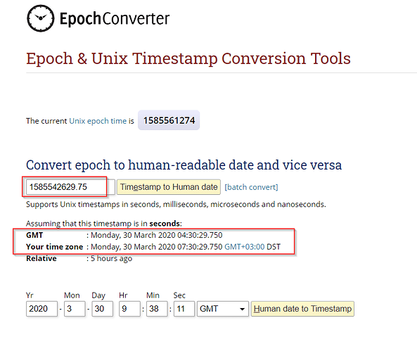

As it can be seen from the image i am loosing 1+2=3 hours totally.
While epoch converter for the specific value provides the following info:

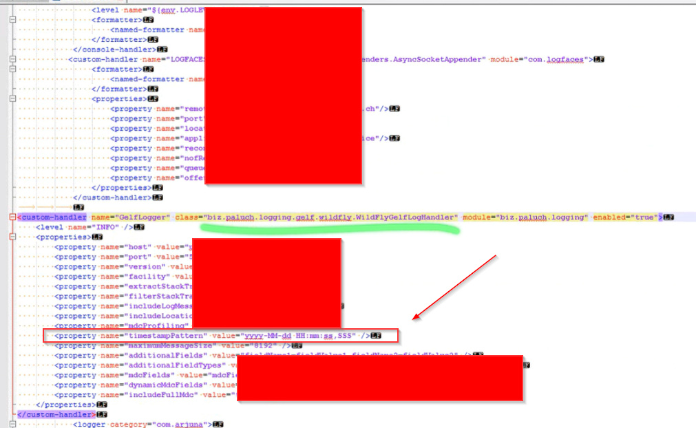

The timestamp pattern in my gelflogger appender is the following:

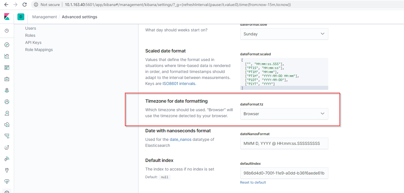

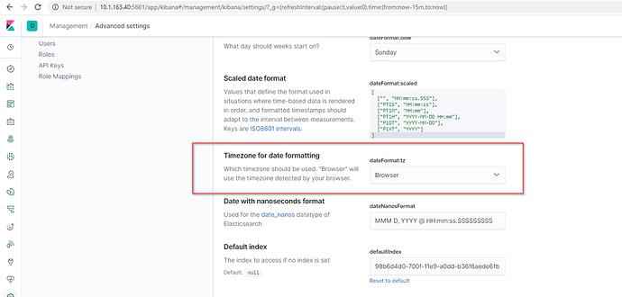

and my kibana date and time settings are as below:

If we change the value of the image bellow to the hour of our country (Greece or Switzerland for example ) problem is solved. Nevertheless, the browser option should work for each country as well.
That leads to the conclusion that something is not ok with the kibana browser setting since it can not take the browser time setting. How can we solve that so it works with the browser setting correctly?
Which version are you running specifically? In 7.6.0 there is a bug which causes Kibana to run in UTC when using the "Browser" timezone - it is fixed in 7.6.1: https://github.com/elastic/kibana/issues/57457
