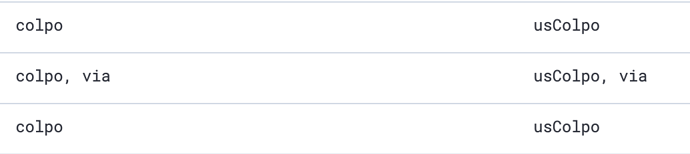

When I go to the discover tab I can see all the values populated correctly but when I add the filter examType:colpo no results are returned. Is it because I return a list to populate the field? I would ultimately like to add a filter control for this field so that I can filter on it in a dashboard.

Can you post an example of what your scripted field result looks like?

I tested using the below data with the mapping shown and it works.

I think I found the issue. It is because they are scripted array fields. This link seems to be my issue: https://github.com/elastic/kibana/issues/61597
That could be it, yes.
My test as you see didn't reproduce the scripted field so that's why it worked for me. :slight_smile:
