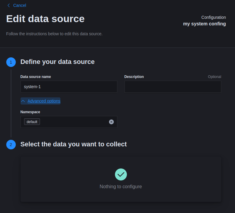

I just found out that I am unable to edit the Elastic Agent configuration data source with the latest 7.9.0 snapshot. It's the same for a new configuration.
Saw this issue #19504 raised, hopefully this will be the solution for the custom certificate authority use case.
