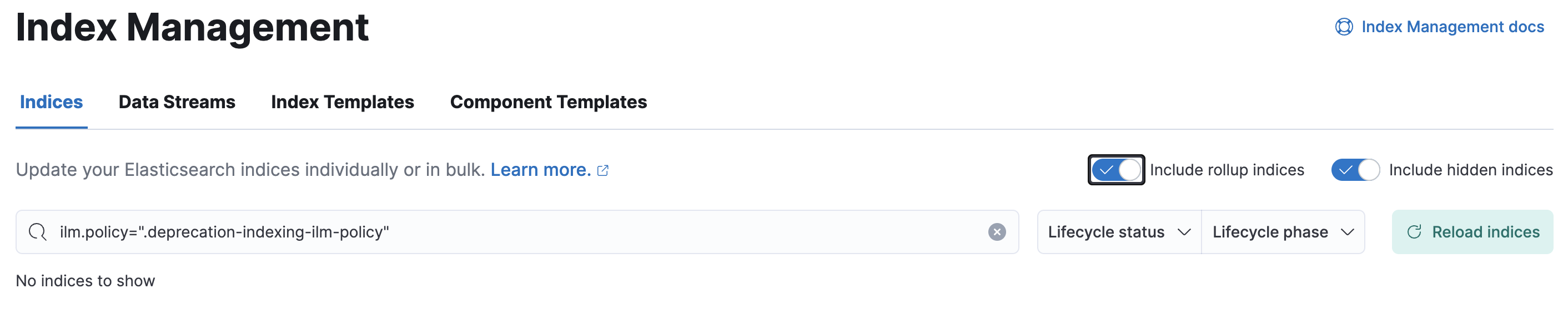

Not sure if it's related or not, but I noticed today when grasping at straws that some of the Index Lifecycle Policies have a count of attached indices, but when I click on that number to see them, it returns an empty list.
Click on the 19, and I get this:
Again, I am not sure if that's just a red herring, or if it's somehow related...

Closing the loop here, I discovered that the upgrade assistant is not reporting on older indices if they have the index.hidden flag set, which is a bug:
