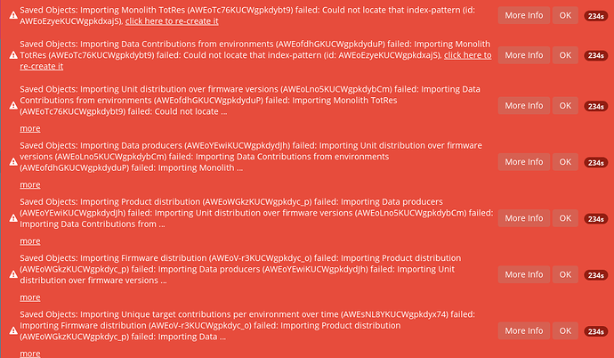

I have previously exported my dashboards and visualizations from docker.elastic.co/kibana/kibana:5.6.2. Now that i try to import them again to the same docker image after a system reboot, the visualizations refuse to get imported. The dashboards seem to be imported but are based on the visualizations so the dashboards are useless.
I'm not aware that i need to do anything special in order to be able to import the visaulizations. I did export using both the "export everything" and the "export" button but neither one of them produced something that can be imported it seems.

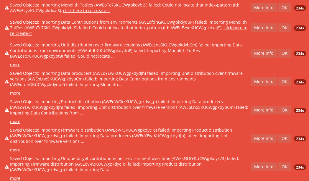

Here are the erros i see.
I seem to get one error per visualization. If i click the "click here to re-create it" link i get to the index creation page but the index used has already been created so i cannot create it again.
The fix here is to first create the index pattern, expand the "advanced" section and put the ID of the index pattern in your export (e.g. "AWE0EzyeKUCWgpkdxajS"). Then, attempt to import.
