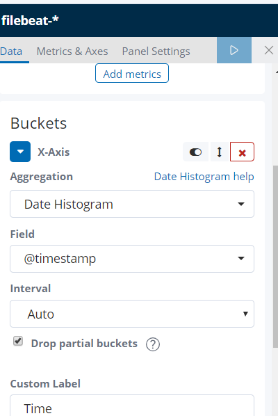

I am getting data from filebeat and reading iis and tomcat logs to check traffic on my internal websites. But my graphs looks similar which I think is not showing correct data. Here is my configuration. Can you please tell me if I have configured it correctly.

You can see my Bar-graph configuration in my previous comment.
