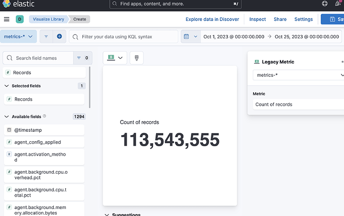

FInd out the nunber of a SUM in a lens visualization.

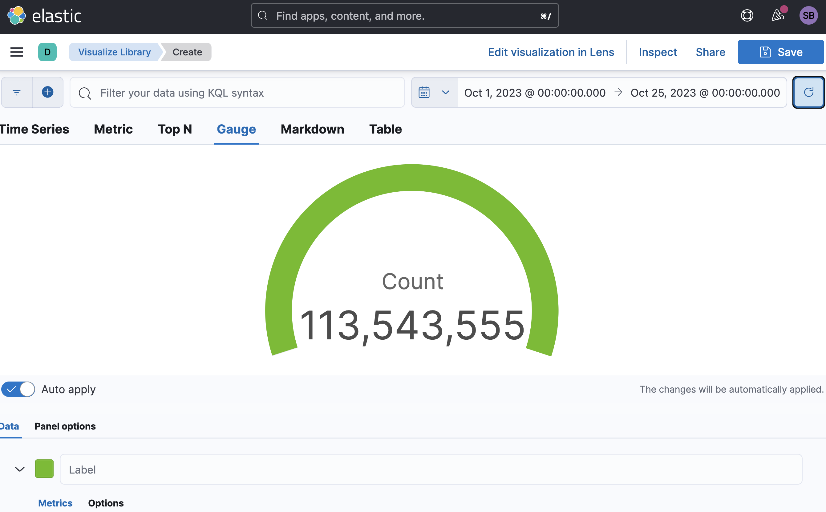

But when I try to do the same visualization in TVSB gauge option, and this is the value that shows:
Are there parameters to adjust?
Thanks in advance

What version are you on... oh 8.6

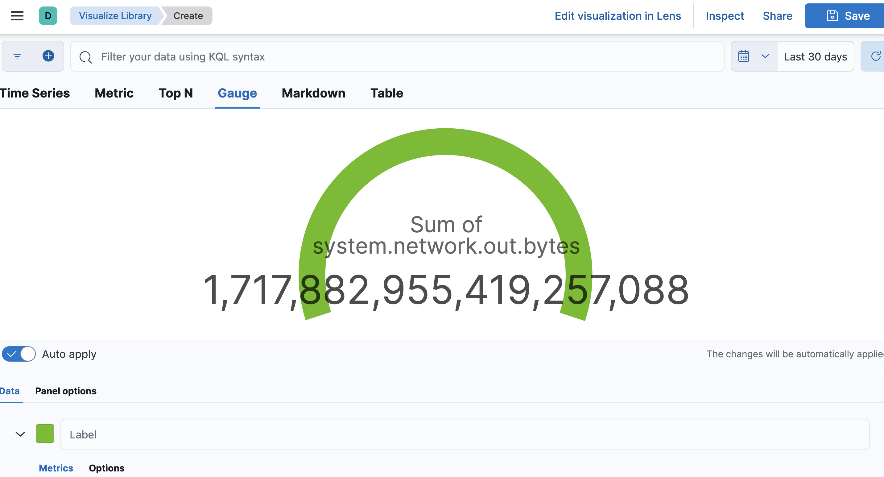

No ... other than are you sure you are using the same index, data view, time range, metric filters... something is not equal.
You will need to show all the settings for both, something is not the same TSVB can show very large numbers ... did this on purpose
Did a quick test of Count I get the exact same results...
Hi @stephenb
Yes, you are right, I was using a different fields in the dashborads.
